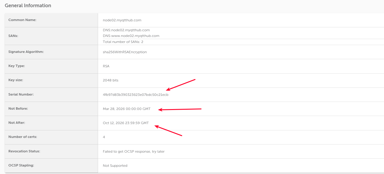

Hello,
Not sure why it is reporting certificate error/mismatch your device. All admision nodes have same front certificate from last 28th March with same serial:
https://decoder.link/sslchecker/node02.myqtthub.com/8883
We are happy it is working for you now. Best Regards
